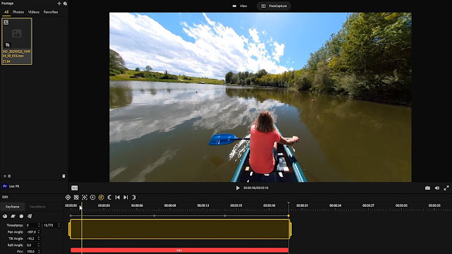

First open Insta360 Studio and import your recorded 360 video. Make sure the Flowstate Stabilization is activated and Lock direction deactivated.

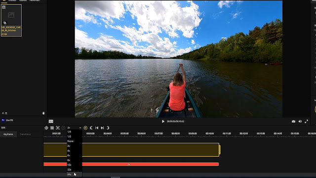

In the next step we had to speed up the video. Switch to the FreeCapture Tab and select the beginning point where you want to start speeding up the video. Then click on the TimeShift button and mark the end point. Click on the Speed factor and select your desired value. I recommend you 32 oder 64.

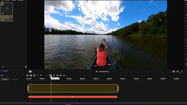

Make sure the Motion blur effect is activated, for processional locking hyperlapses. When you now playback the video the speed and motion blur effect is not previewing correctly. Be patient, you see the final results, after you export the video.
Now the creative reframing part starts. Click on the keyframe button to set your first keyframe at the beginning. I recommend you to select the “natural view” for a dewarped wide angle view. If you want to get an even wider angle, you can increase the FOV value.
Then set your second keyframe and reframe your video however you want. You can add as many keyframes as you like. When you hold down the timeline cursor on move through the timeline you see a preview of your hyperlapse.

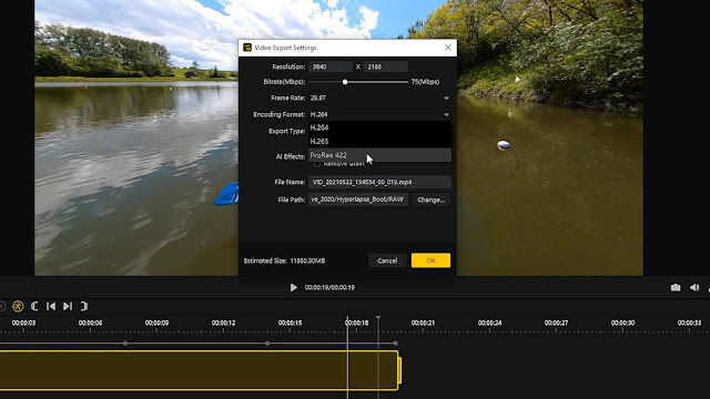

To get the final result you had to export the video. Click on the export button and select your desired export settings. I normally change the resolution to 4k and select the ProRes 422 encoding format, for the best export quality. You can also select “Color Plus” for stronger colors.
Then click “ok” to export the video.
